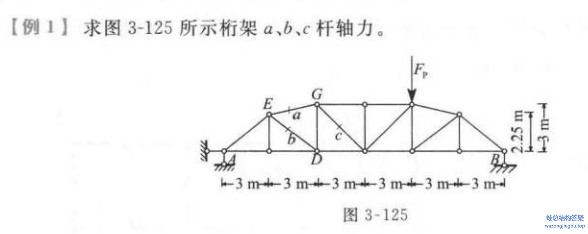

[桁架] 20240407计算 a b c轴力

Nc=0.866Fp拉,Na=0.687Fp压,Nb=0.278Fp拉

Na=0.689Fp;Nb=0.278Fb;Nc=0.47Fb
