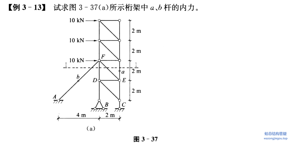

[桁架] 20240401桁架内力

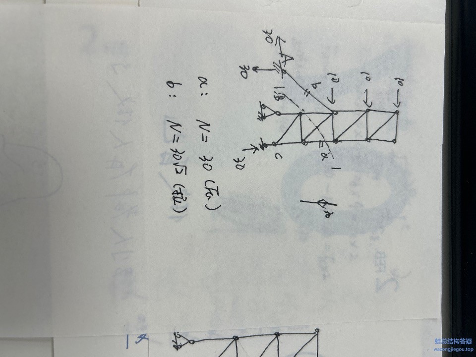

Na=30KN(压),Nb=42.4KN(拉)
N1=-30,N2=42.42
